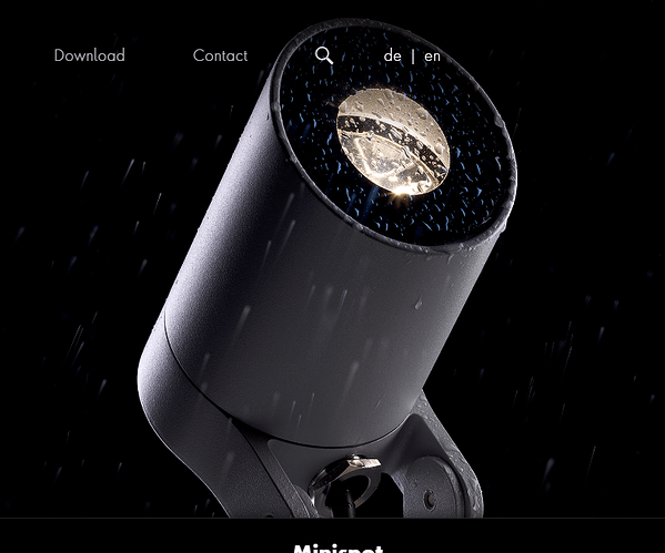

Hello all,

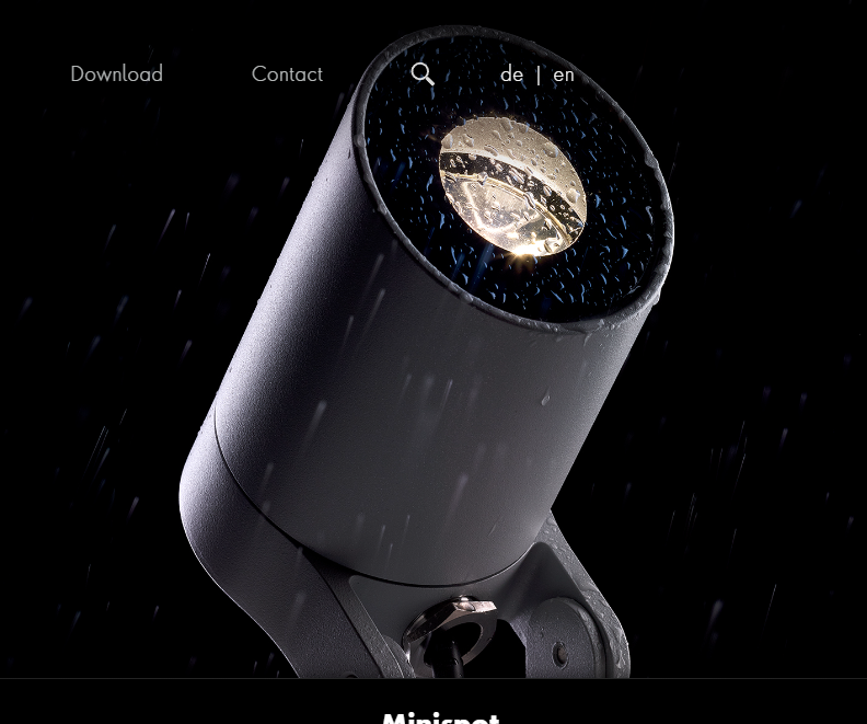

This is the best place i know to ask this sort of question, I am wondering does anybody know if you can create water drops or some sort of concept of water. i have a product that is IP67 rated and i am creating renders for it at the moment… i would love to try showcase its IP with some sort of water drops on the actual product an then over lay it with a photoshop filter… I have atttached a image for inspiration of a competitors image… and would like to know if something like this is doable in keyshot.
Here is a quick tutorial about it.
https://www.youtube.com/watch?v=Lrrsv0PQ90U
but if you want to animation, you should animate the drops in somewhere else like 3Ds Max or Blender or others.
For water droplets on the product itself, the easiest hack is to download the Keyshot coffee bottle model on the Keyshot Cloud, import in to you scene then use that droplets in the material graph and copy and paste it in to your objects material graph.
I’d do the rain in post for an image render
